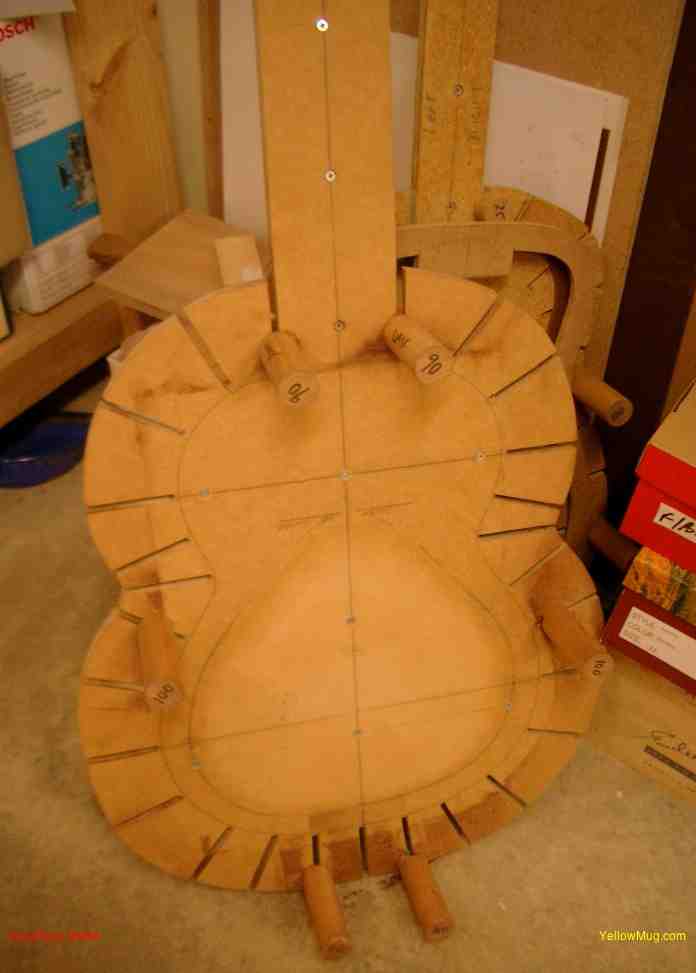

Posts: 1055
Peter,
Heres a pic of the solera I made up for my next classical.
Cheers Martin
